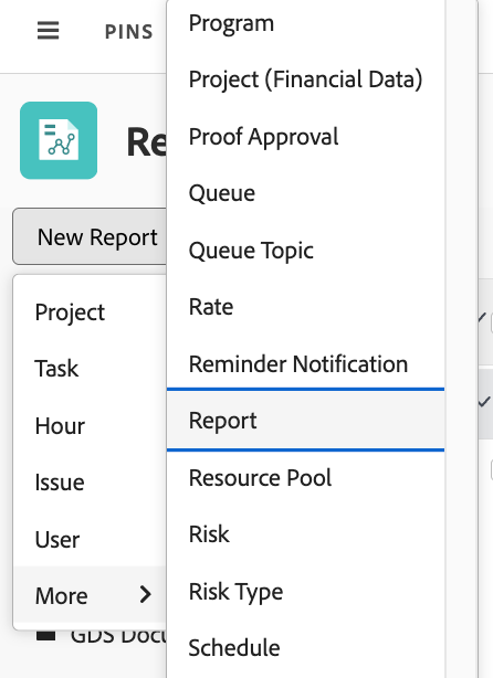

Hi there @MoniqueEvans! Perhaps this is a silly question, but what report type is this report? Since it's pulling in details from all different report "types" (first column), but WF restricts reporting by report type -- this is going over my head how you even built this. I'm intrigued, though. Seems like a super helpful tool, if I could figure it out.
Hi Jennifer! Great question and a very important one if you want to be successful. This is a Report Report. No that's not a typo. This is a report that is listing the reports in your system. And to make one you want to go to Reports > New Report > More > SCROLL DOWN to Report
