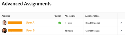

A little more detail on the problem:
  • A project is opened and there are 10 tasks assigned to "Brand Strategist" role.
  • "User A" with a Brand Strategist role is bulk assigned to the tasks.
  • "User B" with a Client Strategist role is added to the tasks to provide support to the Brand Strategist.
  • A new secondary role for "User B" of Brand Strategist is added to their user setup.
  • Need a way to reassign "User B" from Client Strategist to Brand Strategist.
  • Note "User B" has actually completed some tasks as a Client Strategist and only certain tasks need the role swapped.

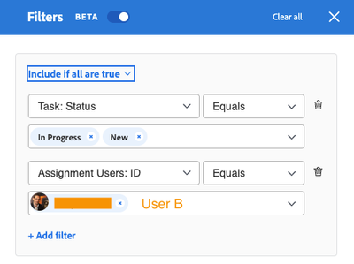

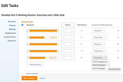

Here is what I did:
  • Created a project filter to only show tasks that were In Progress or New PLUS that had the Assignment User = "User B"
  • Bulk edit those tasks to change the Assignee's Role for "User B" from Client Strategist to Brand Strategist
Here is what I did:
