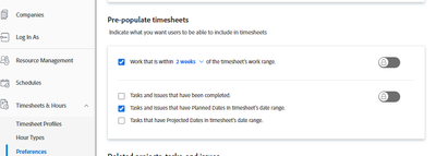

Within the "timesheet and hour preferences" what are your pre-populated fields set to? I'm guessing that the work is not falling within the preset windows. Double check that the planned dates of the work falls within the window that these fields are set to and that the timesheet the user is on is within this window as well. I've included a snip it of that section of the preference area as an example of ours (we don't allow time to be logged to completed items and we don't use projected dates, so we have those turned off completely). So, when our timesheets are created weekly and/or when a work item is assigned to a user that has a planned date that's within the two week window (and within a project that is not dead/complete), they auto populate onto their timesheet. Hope this helps.
