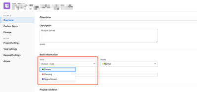

Thanks for responding. The weird thing is under basic information the only option I have is to select the priority.  I don't have an option to select status.
Any thoughts on that?
my guess is that you should check if your admin account has layout template assigned and if yes, check that layout template settings to see which fields are visible for you:
potentially status is not "enabled"
Thanks for the reply.
I logged in as our group admin and checked our templates and doesn't look like we have any.
I was able to find teh template under setup > interfaces > layout templates
Thank you so much!
