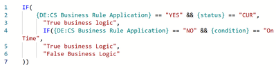

One problem that I was running into a lot was that you can only have one business rule for an object event type, i.e. you can only have one business rule for project updates, but I needed to be able to apply different rules for different situations.
What I did to handle this was to create a "Business Rule Logic" field, then on the templates this field gets configured to determine which logic should be applied.

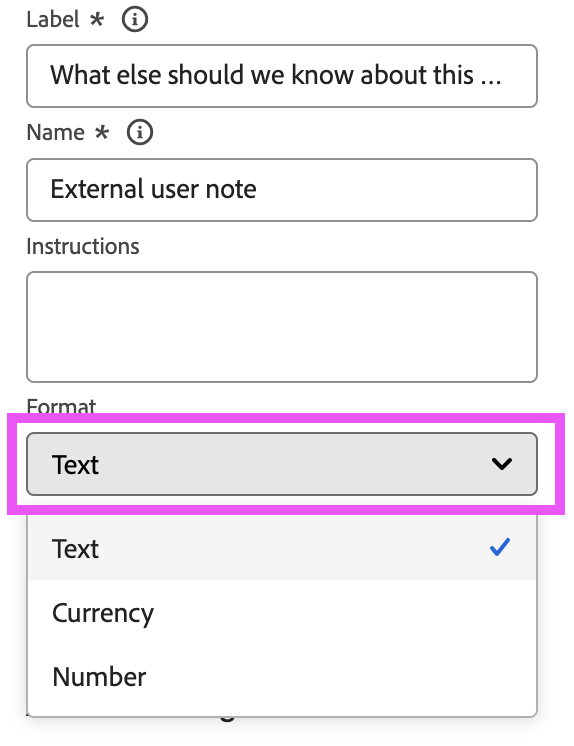

Am I going crazy, or does this not seem to support regular expressions?  I was asked to make an already existing text field not allow folks to enter text, only numbers. I thought I could do this using a regular expression, but the validation editor doesn't like the syntax I provide.  Has anyone been able to get something similar to work?
Something like this:
IF(REGEXP({DE:FieldName}, "^[0-9]+$"), "", "Please enter numbers only.");
@CR17506599 This is an existing setting for fields, so you wouldn't need to set it via validation logic. It exists below the Instructions field. See the screenshot attached.
Thank you! I did try that, but unfortunately, it won't let you change the format of the field if you already have custom forms out there that don't match the new format.  In our case we have several hundred forms with fields that contain text that we want to keep for historical purposes. I thought the new validation rules would be a nice middle ground, but can't get them to work for our particular use case.  We could also make a completely new field and hide the old one, not sure if that would hide the field on the forms that already exist though.
I think you just need to keep trying but yes, to your point, regex doesn't work in calculated fields and therefore, validation logic. Yes, you could make a new field, and you would have to hide the old field on every single form, which is not a big deal except that you apparently have hundreds of forms (??).

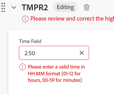

Use case: I wanted to develop a way to enter a time separately from a date. This is for a team who is planning on using workfront objects to store a delivery time (e.g. emails sent at XX time) but often had changes involving time (e.g. for this week, let's send all emails at 2AM instead of midnight).
My first try with the help of copilot, was just to develop a field for HH:MM. I'm still trying to figure out whether I should add AM/PM or make that a separate field.
IF(
  LEN({DE:Time Field})!="5" ||
  LEFT({DE:Time Field},2)<"01" ||
  LEFT({DE:Time Field},2)>"12" ||
  RIGHT({DE:Time Field},2)<"00" ||
  RIGHT({DE:Time Field},2)>"59" ||
  !CONTAINS(":",{DE:Time Field}),
  "Please enter a valid time in HH:MM format (01-12 for hours, 00-59 for minutes)"
