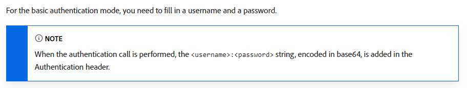

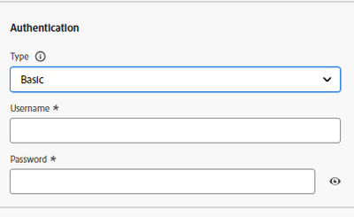

If it is basic authentication, you can switch the type to Basic.
@Mohan_Dugganab , in that case, how to accommodate two calls in same action & retrieve the response header?
If the end point you are trying to hit supports basic authentication, you don't need custom authorization.
@Mohan_Dugganab , Yes, it's OOTB.
But the point is I have to get the security token from call 1- response header.
Then that security token needs to be applied when calling the main api (call 2)
In the screenshot shared earlier, all of this happens in a single custom action & header ( -H "Authorization: Basic <base64 enconded username:password>") gets appended automatically when the custom action is invoked.

@Joydeep Just add call2 endpoint url and username/password in the authentication.
@Anuhya-Y , in that case, I am not getting the API token from call 1 which is required to authenticate call 2.
@Joydeep  Do NOT depend on Call1 to generate the API key. Instead, for Call2, just add the username and password details, which will internally create an API key. Could you please validate the Call2 response in Postman by passing the username and password as header parameters instead of the API key? Also, may I know the name of the external system?
