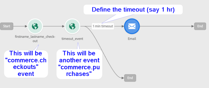

Mohan_Dugganab
March 13, 2024
It would be on the following lines -
1) Create a unitary event (say for example - eventType = 'commerce.checkout')
2) Create another unitary event (with eventType = 'commerce.purchases') and specify a time out say for 1 hour. If you don't see a purchase event happening in an hour from the initial event, abandon cart email would be sent out
Michael_Soprano
April 3, 2024
Thanks for your response!
But there should be some filtering between these two events which checks that commerce.purchases event did not happen?
Mohan_Dugganab
April 5, 2024
If the commerce.purchases event did not happen within the specified duration (timeout), it would traverse down the timeout path and we connect the Abandon message to this transition.
If this event is recorded within the timeout duration, journey would end for the respective profile.
So, no explicit filtering is needed if the check is based on event types.
