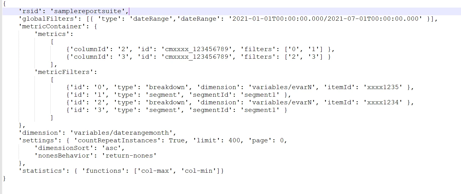

I have a similar requirement as @prerna and I am using the same procedure as you mentioned.
The JSON query through debugger gives a request json like below:
and the response as below :

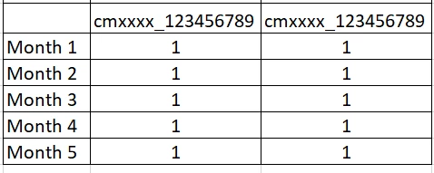

Instead of returning the dimension type values the response returns the calculated metric id 2 times.
writing the data part in response to dataframe gives something like below:
Hope I am clear with the above explanation.

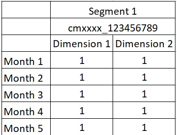

1. Is there any way I can get the dimension values in the response ?
2. If the above is not possible is it possible to get dimension values based on the itemids in the request  screenshot ?
