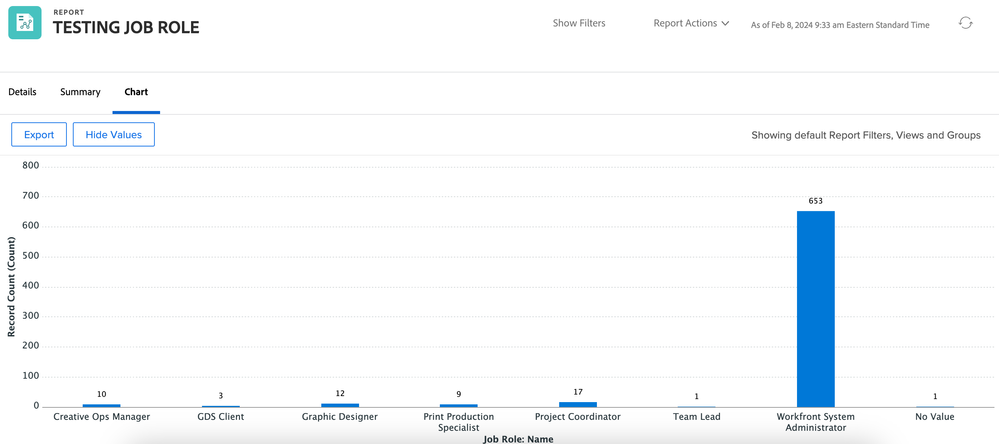

You were so close! Instead of grouping by Assigned To >> Job Role; Group by Job Role >> Name. Workfront will assume the "assigned to" portion and this should give you the expected results.
Screenshot 2024-02-08 at 9.32.55 AM.pngScreenshot 2024-02-08 at 9.33.08 AM.png

Thank you, Monique! Guess I was making it harder than necessary.
