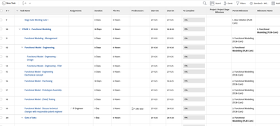

my goal is to return the information from the field Milestone: name to Parent milestone in each line (also in lines that are new created in projects)
ive managed this for 1 parent level deep but not to level 2,3 etc... as shown below:
i created this by using the code:
textmode=true
valuefield=parent:milestone:name
valueformat=
in addition to this i would like to Rename the information automatically.
can any one help me out?

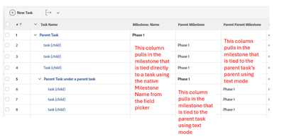

The milestone is only stored on the one object in the task list. Because of this you will have to reference that object to get the information. So to get the milestone, it's either on the object, it's parent, it's parent's parent, etc.
Example with a single milestone tied to only the top parent task
displayname=Parent Milestone
linkedname=parent
namekey=view.relatedcolumn
namekeyargkey.0=parent
namekeyargkey.1=milestoneID
querysort=parent:milestoneID
textmode=true
valueformat=HTMLdisplayname=Parent Parent Milestone
linkedname=parent
textmode=true
valuefield=parent:parent:milestone:name
valueformat=HTML

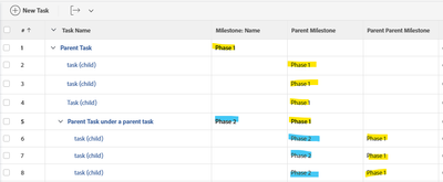

Data will fill out a little more when you get into a place where you are using multiple milestones in your project as below:
thanks a lot this is in the right way but i prefer just 1 column with the information. is this possible?
