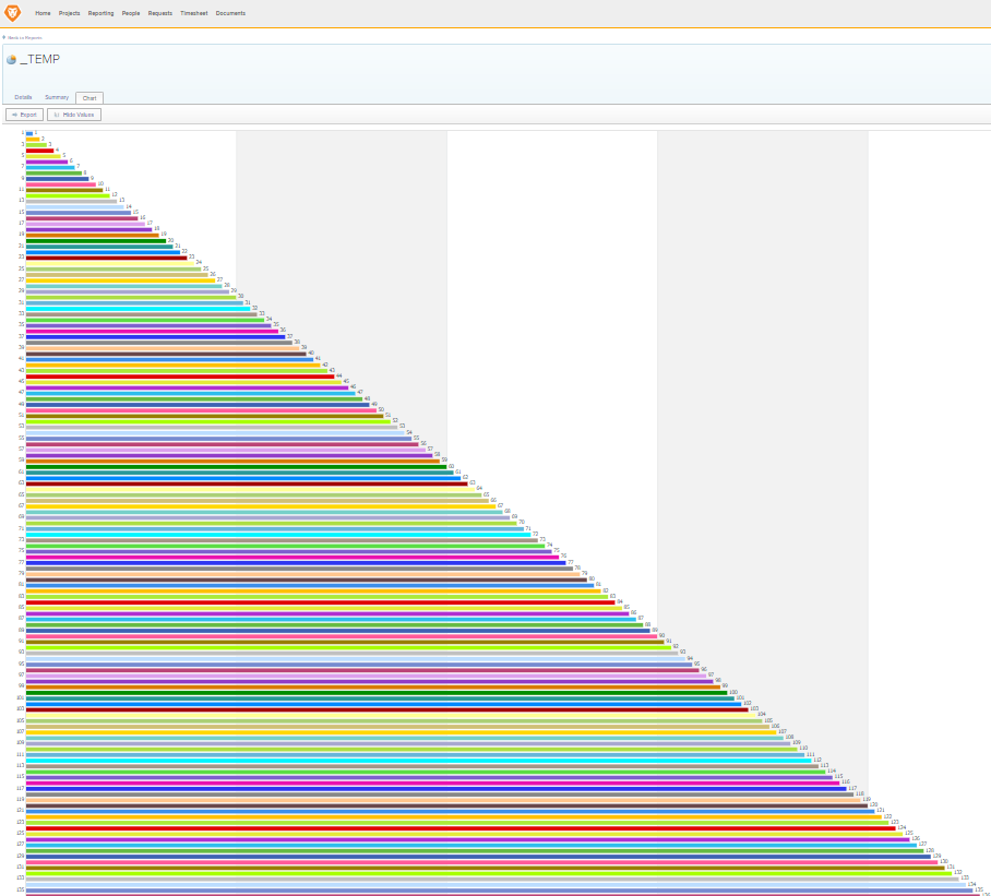

Second, noting that on every project, the last task's number is in fact also the same as the count of the tasks (sneaky way):
  • Create a Task report with View = Project Name, Task Number (Max, descending), group by Task Number, Project Name
  • Add a bar Chart
  • Run the report, then click any bar to see those Projects with that many tasks (see below)
  • Or look at the details
  • Or make it a matrix
