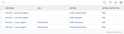

My suggestion would be to create a project from each template and then run an assignment report. This will result in multiple line items for each assignment in the project broken out for each assignment instead of just the default assignee. Similar to below:

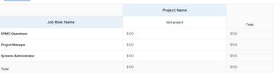

Then you can group this anyway you'd like (summary or matrix view) and set the job role column summarize as an "average". Here is my data from above in a matrix view:
