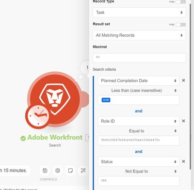

The approach I would take is as follows:
1) Add Search module that will look for tasks. Configure the filter rules to look for tasks where the plannedCompletion date is less than today, the status is not complete, and the role ID associated with the task is the "unnassigned role" you mention. + Any other relevant filter rules to narrow down your search to the specific tasks that need to be auto-closed (i.e., Template task ID).  It would look something like this:
2) Than add an update record module, mapped to the task ID's located in step 1,  that will update the status of that task to Complete ("CPL")
Hope that helps! Shout if you have any questions.

Hi Kiersten,

Thanks, Rich! I will take a stab at it.
I finally was able to get around to building this and it worked our perfectly! Thank you so much for your help!
