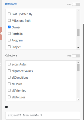

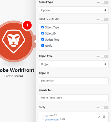

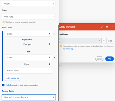

Level 7
Instant webhook event to catch status change
Read module to read user info if you want to add name to message (We usually send updates to owner/sponsor) you did not specify to who
Create record Update to map the object ID, object type, message to send, and user/team ID to send to
