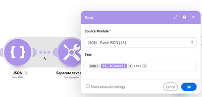

I'm working on a scenario to export one of our forms to a Word template document.    It's was working pretty nicely until it came to one of the custom fields that contains rich text.
Is there a way to have the rich text export to the Word Template as it is coded?  If not, I know it is JSON coding, and I am trying to parse it so it can be removed but how can I then combine
all the collections into one variable so it can all be exported to Word as one field?

Hi Frank,
You'll still need to parse the JSON from the rich text field and you can use the text aggregator to just get the text part of the RTF field so you have it for your Word doc.  I think I'm following your question, hopefully.  See below, I have a scenario where I need to get the text from an RTF field mapped to a field in a Word template I was using and did the following below.  I believe you should be able to do the same thing using a variable in place of the text aggregator OR you could write the output of this text aggregator to variable, if needed.

Thank you @Kurt_Jones .  Very simple solution.
