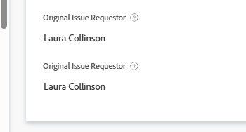

I've created the first field to capture the Primary Contact {owner}.{name}
The calculated filed is written as this...
IF(!ISBLANK({convertedOpTask}.{DE:C+D Original Issue Requestor}),{convertedOpTask}.{DE:C+D Original Issue Requestor},{owner}.{name})
When the issue is created and the Primary Contact field amended, then this shows correctly in field 1. Second sets to enteredBy which I'm also ignoring.
But when the issue is converted to a project, the first field updates to the project owner (which I don't mind as I shouldn't be using that. But the second which I'm planning to pull into my report also updates to the project owner.
Do you have any ideas how to fix this please?
I'm sorry this is so long and thanks for your time.
Matt
