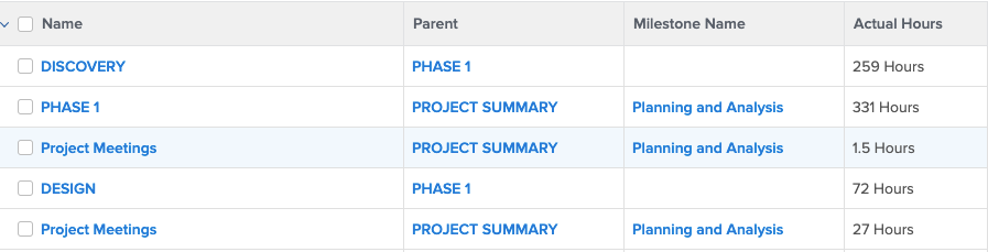

On a Task report, this textmode pulls the milestone name of the parent task.
valuefield=parent:milestone:name
link.linkproperty.0.name=ID
link.linkproperty.0.valueformat=int
link.linkproperty.0.valuefield=parent:milestone:name
link.valuefield=parent:objCode
link.lookup=link.view
link.valueformat=val
descriptionkey=Milestone
textmode=true
shortview=false
stretch=0
linkedname=milestone
valueformat=HTML
namekey=parent
displayname=Milestone Name
width=150
querysort=parent:milestone:name
listsort=nested(parent).string(milestone)
In the screenshot, you can see the Task, it's Parent, the Milestone Name associated with the parent and the Actual Hours.0694X00000DTShbQAH.png
