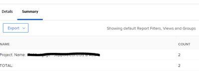

Otherwise, reversing this as noted by Doug into a task report could work and you could filter out parent tasks if needed. Then group by project and view the summary tab to see how many are for each project.
