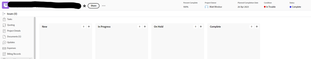

I'm in Preview (thankfully) and have turned it on within issues, but now I can't see how to turn it off. Has anyone found a way around this yet?
I believe it’s on the far right in the toolbar with views/filters/etc that you can turn back to list view.
Former Community Member
Hi Madalyn,
That's what I would have thought, but after I select Boards view all the view options disappear. This is only in Preview as I'm don't want to ruin Production.

I'm not seeing a Board option from Issues, only Tasks...
I'm looking at the new Issue options in Preview mode, but I get the same problem the tasks. Adobe support are arranging a call with me to run through this.
Thanks for looking into it.
Any progress on this? I have some users that are locked out of their task list too
HI, support escalated to their development team and the issue was then fixed for our instance. The only thing left over was that when I was in the issue view, it still said Add Task instead of Add Issue, but it did just open a new issue. Just something cosmetic really.
Unfortunately, I don't know what they did t fix this, so you may need to go back to through support on this.
Good Luck
Matt
I had users in my instance run into the same issue. I contact Support but I don't think they did much to help. What did help was the affected user clicked "Help" on the top menu bar, then the Boards page reloaded and allowed her to click back to Lists. Not sure why that worked for us, but it did!
