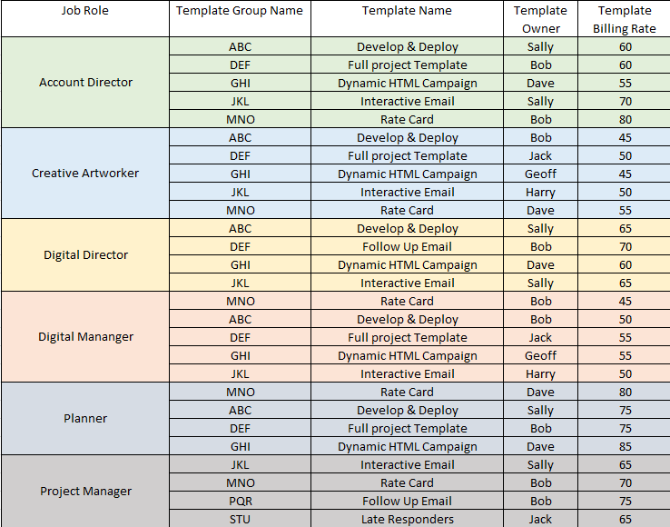

Hi Community,
Our company is consolidating job roles and standardising role cost across all of our project templates. I'm having difficulty creating a report that helps me identify which Job Roles are contained in each template and what the associated Billing Rates are. The below screenshot shows what I'm trying to achieve. This should list out all of the job roles in order so that I can update the Job Role and/or make the billing rate consistent across templates.
Can anyone offer advise into how I can created this please? Thank you in advance.
