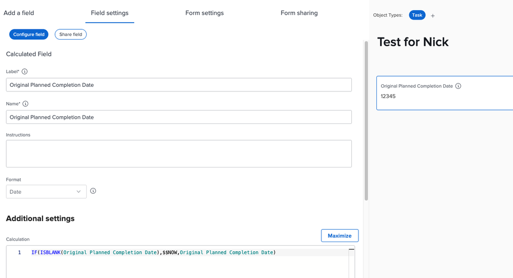

It is the custom field. Here is how it looks to me in my instance
Is maybe the format not set to Date?
Thanks for the screenshot. I see where the confusion was now.
