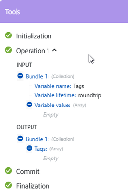

Here is the input bundle if that helps:
        "name": "Tags",
        "scope": "roundtrip",
        "value": []

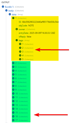

Pointing the '2.body.data' variable to '2.body.data[].tags' instead gives me values, but only from the first data array.
Highlighted yellow are the tags I am getting
and green is what tags I also need included

If you map your notes array into an iterator, then you can pull your tags for each comment by referring your map command to the output of your iterator. If you want to pull them back into a single array, then put an aggregator in place.
