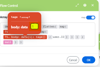

Hi Dan,
Thank you for the reply, unfortunately I am not getting any values from that.
Here is the input bundle if that helps:
        "name": "Tags",
        "scope": "roundtrip",
        "value": []
Pointing the '2.body.data' variable to '2.body.data[].tags' instead gives me values, but only from the first data array.
Highlighted yellow are the tags I am getting
and green is what tags I also need included
Any ideas?

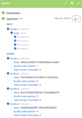

If you map your notes array into an iterator, then you can pull your tags for each comment by referring your map command to the output of your iterator. If you want to pull them back into a single array, then put an aggregator in place.
Chris,
My expression above was indeed put into an iterator, yet I only got the user ID tags highlighted in yellow. I need also the IDs above highlighted in green.
Is my expression incorrect?
I essentially have one array that contains several arrays, each containing a user.ID or a team.ID that will ultimately be put into an array formatted to enter into a notify module. I have most of this figured out, I just can't seem to get each unique user and team ID in the entire topmost array, and only get the data from the first tags[1] array.
How do I make the body:data point to all data sets instead of just [1]?
