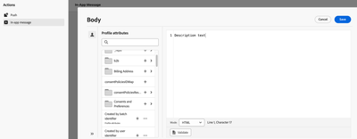

Does anyone know if we can use offer decisions within the in-app channel that’s part of a journey? When I look at the in-app message interface within a journey, it’s not showing offer decisions, rather it’s only showing profile attributes.

No, it's only profile attributes at the moment.

@pulkitvashisth I have setup an offer with appropriate placement, representation, etc. However, I can’t see the option for offer decisions within the In-app message. Here is a screenshot of the In-app message content section where I’m trying to find the option.
Whereas, if I choose push, I can see the offer decisions tab within the push message.
@Mohan_Dugganab Thanks!
