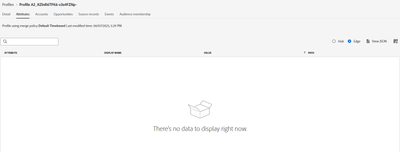

Thanks. I've created an In App campaign with an Edge Audience but still not working. Anything else I must know when adding Edge Audiences to In App campaign? Thanks.
So, here an example of my profile. Any of those attributes will work in an audience because are not Edge? (look at the hoob checkbox)
I don't have any attribute for "Edge"
Should I add Edge attributes and then create the AEP audience with that Edge attribute?
Thanks.
