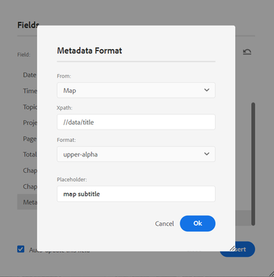

To render the subtitle in PDF, you can use metadata fields. For this, you need an element inside topicmeta or bookmeta containing the subtitle value.
Below is a sample where I have added the subtitle inside topicmeta.
Added the metadata field to my first page with xpath value:  //data/title

You can achieve this through Fields metadata, which is like a variable and you can insert anywhere in the page layout. You can find the details on this page. We did a workshop in one of the expert sessions. Let us know if you still face any issues. It is supported in your version.
Thanks for the quick response again, ViveKK! The presentation you referenced is very helpful, however I don't have all the options that the presenter did.
I'm able to pull the title and copyright logo from the DITA successfully, but I'm still having trouble with the subtitle. I've attached the code I'm trying to use for the front page template.
Do I need to change the data-subtype? (The illustration for where this is in the DITA is in the previous attachment.) I've seen some that include an "@xxxx" on the end. Where would I need to use those?
