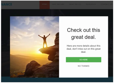

I am using Experience Templates To set up a lightbox overlay pop-up in my experience to display pop-ups to my defined user. Itlooks like something as below

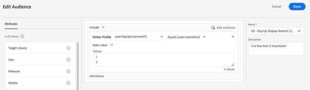

I have applied impression capping to the POP UP display by restricting it to 2 times display as below:
1) Set up the Nested Mbox parameter in the experience via XT under Modification as custom code
2) created a profile script for pop up increment value capture
3) Created Audience to restrict the pop-up display to 2 times
However, when I set up all the above for overlay pop-up in my experience then why some users don't see it? Does the set up looks correct? To me, the steps look good. Pls, suggest.

Hi @JyotiSharmaV,
The setup looks correct, but I would try changing the audience to use 'exclude' as follows:
I have seen this work more accurately when trying to cap user impressions.
You should be able to test this audience by toggling on the 'Match audience rules to see experiences':
Then, use the QA link in an incognito tab. After reloading the page three times, you should no longer see the pop-up.

@Matthew_Ravlich_ACG This is so so strange that Exclusion set up works and Inclusion doesn't. I tried tested with my fellow folks and its working
Thank you for the suggestion.
