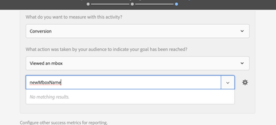

The mbox doesn't have to be called "conversionTest", you can name it anything; you can just type it into the field even if it doesn't already exist, so I can add a new mbox called newMboxName and it's not a problem that it shows "No matching results"

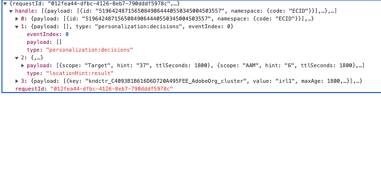

Could you share what's in the response payload from your first sendEvent request? e.g. should look something like....
Yes sure, here it is:
The personalization:decisions payload from Target is empty, which implies that there is no match in for the mbox name (decisionScope) that was sent in the request. Is the activity live in Target?

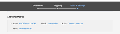

You wouldn't have an empty activity with that mbox name, you would just add a metric - with the definition of mbox name = myMboxName - to your real activity in the Goals & Settings section. Like this:

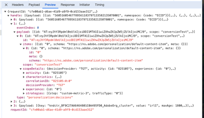

Thank alexbishop,
Now I´m seeing the two interact requests, the second with the event type "decisioning.propositionDisplay"
Now I need to wait if that add to the total mbox count of my activity.
Thank you!
Great, that's working as expected then, at least in terms of the two interact requests. Typical latency is around 4mins for the metric to update in the reporting UI
