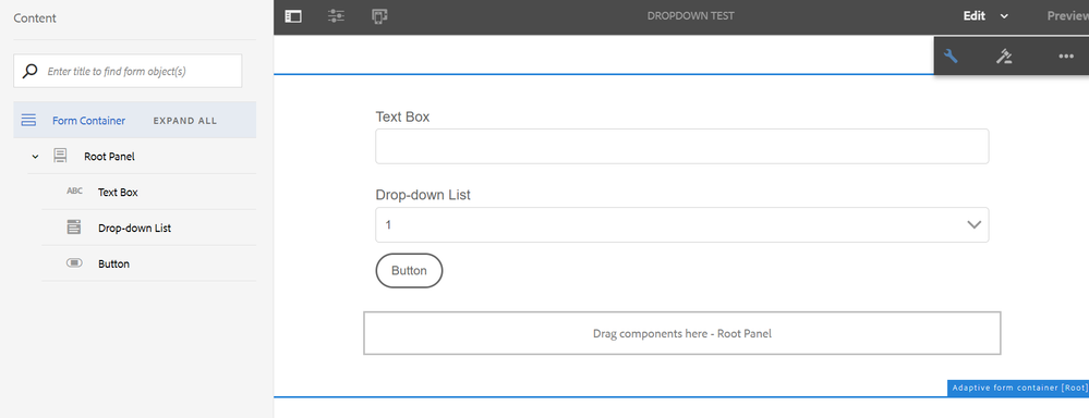

I created a test with a textbox, a dropdown list (multiselect), and button
the textbox resets the dropdown list when you change the value of the textbox.
the button is just a click event that is there for pretending i am doing something with the textbox value. it actually just writes to the console.

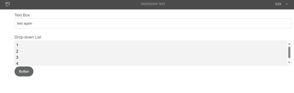

so i write something on the textbox and click the button, this should reset the values of the dropdown. then I choose one item
then i do it again i write "test again" and click the button, this clears the items from the dropdown list

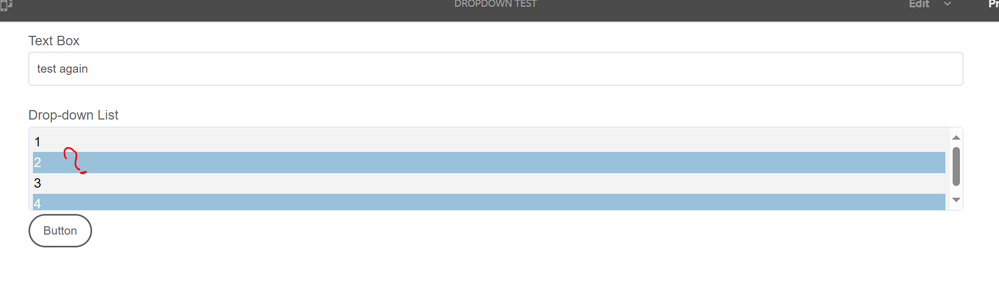

then i click on "4" item of the drop down list and the value "2" comes back.
but ddlist.resetData() was supposed to reset the data of the dropdown and "2 was not supposed to be highlighted. this is happening in AEM forms 6.5 SP19. can you please try in other services packs? or did i miss something ?

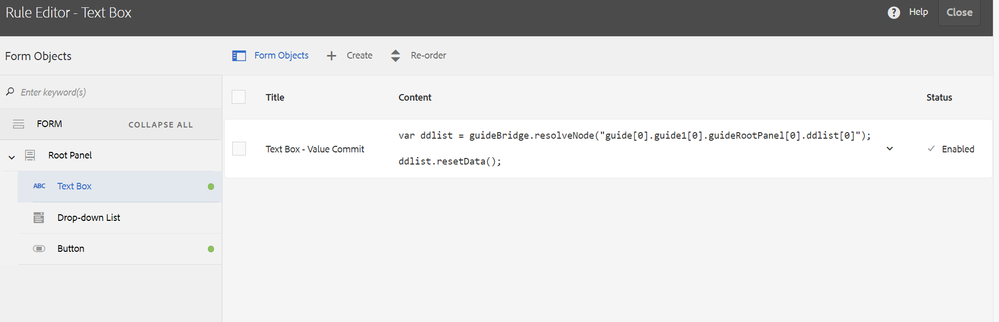

@PowerUserOne send me your form I will test in lower version
yesterday i tested it in SP11 it did not work
it is very simple, add a text box, a multiselect and a button (button is just for pretending you are clicking after changing the text on the textbox) just like in the pictures. the textbox Value Commit event of the textbox should reset the multiselect dropdown and it does. but when you click something after that the selections from before the reset comes back. please try it. let me know.
