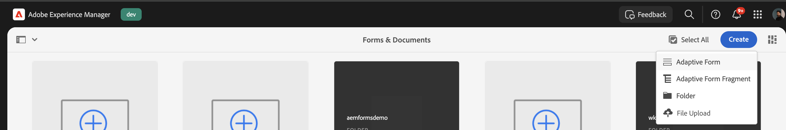

- Opened forms sandbox "Navigation" pane
- Selected "Forms"
- Selected "Forms & Documents"
- Clicked "Create" -> "Adaptive Form"

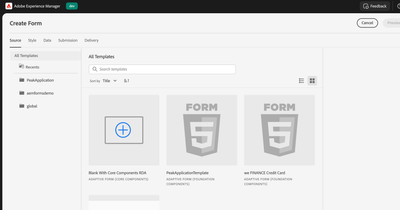

- In "Create Form" pane (see below pic) -> Clicked "Blank with core components"
- It doesn't let me "create" yet, so went to "style" tab and clicked "Canvas" option (see below)

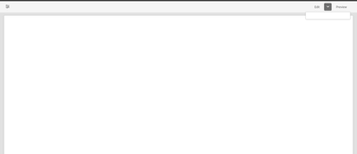

- It opens a new window with the created form, but i see nothing at all. And clicking edit or preview does nothing either. (see below).

@SaadAb To confirm are you using a local setup or a cloud instance? Could you share any errors in the browser console which you are observing.
Also, could you validate - if the proxy components defined in the template/form are available on your environment.

One needs to enable forms in AEM Archetype to get the proxy components. If you could share the archetype.properties from the repo mapped to your environment - I could take a look. It should have includeForms as enabled.
We recently included the core-components in FAR which eases the changes, and one can build core-components based forms without the archetype. For this - you could create a new template - and modify the allowed components to include components under the section 'Core Adaptive Forms'.
(PS: I had the component group already selected - but you should be able to see the same, and include in your new/existing template).

Hey @sudhansh thanks for the detailed response. However, Im not sure what you mean by FAR, but regardless as you can see in my screenshot - when i select "create" from the "forms" path i follow from my sandbox landing page; it doesn't take me to a template creation path, rather shows me the options for which type of form to create. Not the same as what your Experience manager page is showing in the vid.
