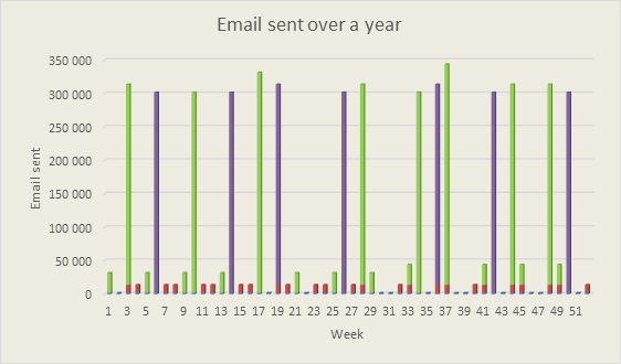

What would my approach be if I need to send emails with a bit more inconsitent frequency? See image as reference.
Every week I send about 2000 emails of a more transactional nature (blue).
Last two weeks each month I send about 30k emails, also more transactional (red).
First week each month I send campaign email to about 30k receipients (green).
Then we have the spikes, green and purple, of about 300k receipients spread out through the year with no consistent schedule.
I am using an IP with a high Sender Score (97) and have been using that for a couple of years, so I don't expect any need for warm up to gain reputation and such. But what about cool down? Will that occur if my number of emails go down a couple of weeks, such as between weeks 20 and 26? What kind of impact will that have on my scheduled send out to 300k week 26?
