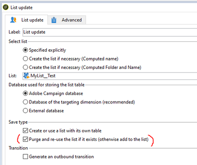

HI @mtraverso1 ,
If you want to purge the list and need to insert the new records, you can enable 'Purge and reuse the list if available' option in List Update activity.

In List Update, Select the same List and enable purge the list checkbox.
So now the workflow checks whether your List has any records, And if records exist, then it will purge the list data but the structure of the list will be same as before.
