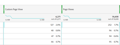

Hi Team,
Doubt on AEP SDK IMPLEMENTATION:
I have two xdm send events
1. For pageload and
2nd one for Interactions/link click
My problem is: my link clicks got counted as page view it causing 2 pageviews.
I do have proper setup on web details class in schema value of pageview 1 and link click 0 for pageload event.
Links click 1 and pageview 0 for link click event. Not sure why link clicks incrementing pageviews. Anyone can help me on this
Note: Custom events are working proper it have exact pageview count but out of the box pageview metrics double counted.

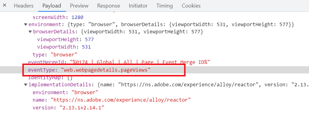

Dear DhanA2,
Page Views are not just based on the Schema Value with Page View equals 1 or Link Click equals 1, but only based on the event type.
Set the page views properly like the one below.
Page View Call:
Non-Page View Call (i.e. Link Clicks):
So, set the Event Type properly, it will be resolved.

Hi @PratheepArunRaj ,
Thanks for your response in my case event type also set as you mentioned but still I'm getting two pageviews, Do I need to focus on any other configs?

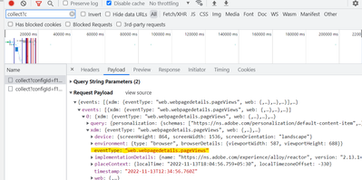

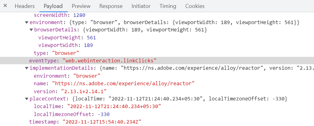

Hi @sumit_nijhawan and @yuhuisg , this is interesting. I am facing the same issue of multiple page views even though I disabled the "Web" checkbox. I see all interactions on the page are increasing the page views and reloads count.
Below are the screenshots of Page View and Link Click. Link click is triggering on subsequent page load server call as I have enabled default link click data collection settings.
Is it a known bug in Web SDK? Or is there any alternative to tackle this?
Thanks.
Hi @AbhilashSh , From the screenshots that you have shared, it seems like beacon call is getting pageName from somewhere in your implementation.
For a Adobe Analytics beacon to be identified as pageview, it needs either pageURL or pagename. Re-check your implementation code and you should identify how pageName value is getting passed in a linkClick

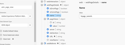

Hi @sumit_nijhawan , I checked my implementation. The only reference I use to pass pageName is through the Web SDK settings on page load event through a data element as shown in the below screenshot.
Other than this, I am passing the page name in a separate eVar.

@sumit_nijhawan , Thanks for your help. I verified my implementation. There was no issue with the pageName variable. It was quite opposite though. I was able to pinpoint and fix the issue. As per Adobe documentation ( https://experienceleague.adobe.com/en/docs/analytics/implementation/vars/functions/tl-method ), for all server calls that needs to be treated as link clicks, below values should be set.
In my implementation, I had set only eVars, props and events in Web SDK and ignored Link name, URL and type.

Can you show a similar screenshot but of your "webPageDetails" object in your XDM schema for both pageviews and link clicks?
