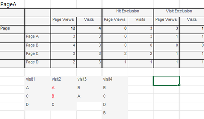

Let's look at a few simple segments:
Example 1:
VISITS [
    Page equals Page A
    AND
    HIT Container Exclude [
        Page equals Page B
and
Example 2:
VISITS [
    Page equals Page A
    AND
    VISIT Container Exclude [
        Page equals Page B
And the following Visits:
Visit 1:
  • Page A
  • Page C
  • Page D
Visit 2:
  • Page A
  • Page B
  • Page C
Visit 3:
  • Page B
  • Page A
Visit 4:
  • Page B
  • Page C
  • Page D
  • Page B
Now, in my simple segments, I don't care about the order of the pages... so it doesn't matter if Page A or Page B comes first.
In both examples, Visit 4 won't be included, because Page A wasn't seen.
However, when we start to look at the difference between excluding based on HIT or VISIT... this is where you will see the biggest difference:
      Hit Exclusion Visit Exclusion
    Page Views Visits Page Views Visits Page Views Visits
Page   12 4 8 3 3 1
  Page A 3 3 8 3 1 1
  Page B 4 3 0 0 0 0
  Page C 3 3 2 2 1 1
  Page D 2 3 1 1 1 1
So the first segment says "get visits with Page A" (which is Visits 1, 2 and 3), then only excludes the HITS for Page B (so the visits still count, the page views just go down a bit to account for Page B not being included.
The second segment starts the same as the first, "get visits with Page A", but then excludes the Visits that contain Page B, so the visits (and all the page views from the other pages in those visits) are excluded.
When you only exclude the HIT (i.e. exclude the HIT of Page B) the rest of the entire visit is still counted, both as individual page views and at the Visit level...

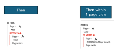

One more thing I’m curious about:
When I create a segment using the method you explained and add a “within 1 page view” condition, why does the data look the same as when I don’t include that condition?
It's possible that your exits almost always follows Page A (it's the primary flow), so the values don't look that different?
The Segment that uses the "Within 1 Page View" should be a little more specific, as it will only account for:
A > exits
but shouldn't count
A > B > exits

Actually, I was researching the difference between "Page A > Exit" (immediate exit) and "Page A > Page B > Exit" (exiting after visiting another page). To identify immediate exits, I used the "within 1 page view" condition.
However, since the exit page doesn’t usually follow Page A directly (which is the main flow), the values look the same, so I wanted to ask about that…
I want to find cases where the user exits immediately without visiting any other pages.
Yep, I get that, which is what the "Exclude Visits that have A THEN Page Exists", any visits that have any page following your Page A should be excluded... leaving you with only exits following A.. if that isn't the case, we can go back to the drawing board....

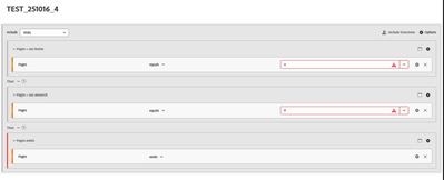

The segment for "Page A > Page B > Exit" seems a bit complicated to create using the method you first shared, so I’m still thinking about how to do it...!
Yeah, in my original segment, I was keeping it "HIT:" level to try and capture the Page As in the sequence (I always try to keep the scope as low as possible, where possible; however, now that we have a three page sequence, this probably isn't going to work (and since you are pairing with Visits, and not with Page Views, it should be fine)
VISIT [
   VISIT Container [
        Page equals a
        THEN within 1 page view
        Page equals b
    AND
    Exclude VISIT container [
        Page equals a
        Page equals b
        THEN
        Page exists
Try this?

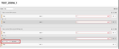

Thank you so much for thinking this through with me. As you suggested, I created the segment accordingly. However, since I wanted to track users who bounced right away, I added a condition for "within 1 page view." Strangely though, the numbers seem to be the same whether I include that condition or not, which is why I’ve been puzzling over it.
I'm also trying to understand why the numbers differ from those of the third segment.
