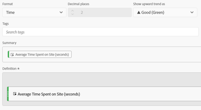

Average Time on Site and Average Time per Visit (seconds) are both a calculation of the visit length based on the timestamp... one is presented in "time" format (i.e. 00:23:07), the other is shown as "seconds" (i.e. 23.13)... if you create a new calculated metric using Average Time per Visit (seconds) and set it to "Time", it should match the Average Time on Site:
