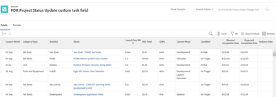

Sorry having problems getting any value, true or false for the following script, and not sure why.
displayname=Delivery Date
listdelimiter=<p>
listmethod=nested(tasks).lists
textmode=true
type=iterate
valueexpression=IF(CONTAINS("Shipping Ocean",{Project}.{Task}.{name}),{"dueDate"},"0"))
valueformat=HTML

The above isn't returning any values still.  I stold the script from an example that was somewhat similar on the board, unfortunately still not getting it done.
My concern here is that this is a project level report, and I'm trying to run the IF statement at the Task level, to return the due date for the task.
If I replace the Concat portion with a fixed value it returns a true statement value, so that's good, but I can't seem to get it to return the date, and it seems to return multiple true values for the single project line.

The one you have above appears to be returning the number of tasks from the project with the value as 2. I'm surprised the one above doesn't work...I adjusted the task name to match what you have in the reply.
This is just strange, I can't figure out why this isn't working, it should be.  Is it that this is a project report and it doesn't see that I'm looking for the Task Name field?  And the Task COmpletion date field?
