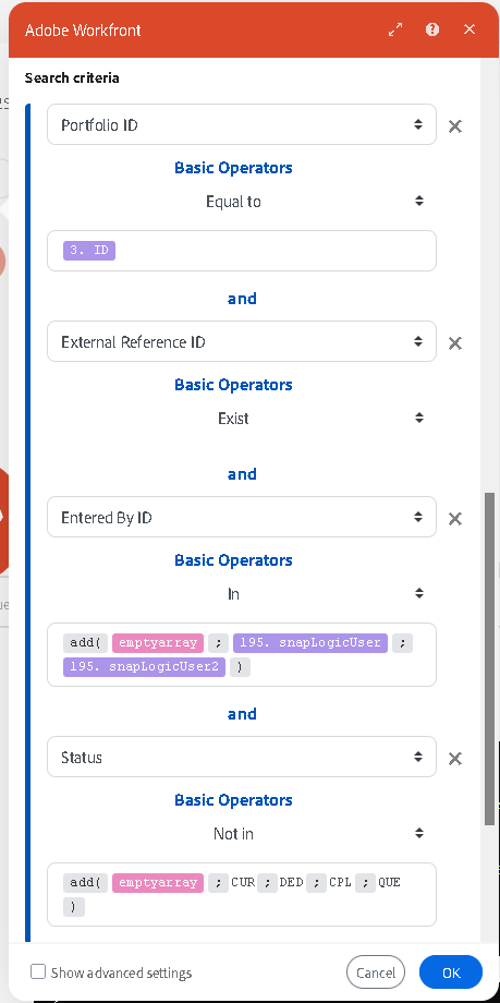

I have a Workfront Search module in Fusion that searches for projects that
  • are in portfolio X
  • and were entered by user A or user B
  • and don't have status X or Y or Z
  • and have the External Ref ID field populated
I would like to achieve the same using the Workfront Custom API Call module. So I tried to "translate" the filters into query string parameters.

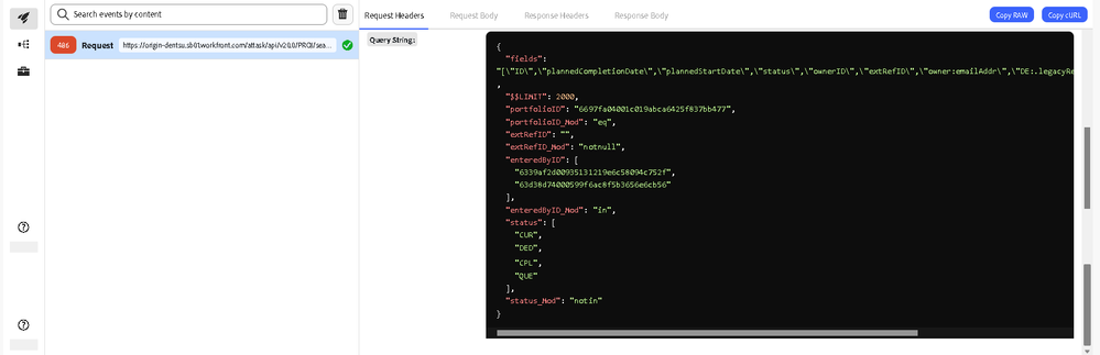

When I check the DevTool -> Live Stream in Fusion, I can see that for request produced by the Workfront Search module, the Query String appears to be a JSON block:
Does it mean that somehow a complete JSON block can be sent to the /project/search endpoint? (If yes, how?)
Or it means only that what Live Stream displays as "Query String" is actually not the query string sent to the API, only what Fusion uses to generate the query string?

Hello Tibor,
You can use the Filter paremeter to pass JSON as explained here.
Your call would look like this:
/PROJ/search?filters={"status":["CUR","CPL","QUE","DED"],"status_Mod":"notin","extRefID_Mod":"notnull","enteredByID":["<id>","<id>"],"enteredByID_Mod":"in"}
Regards
Lars

Hello Tibor,
Regards
Lars
