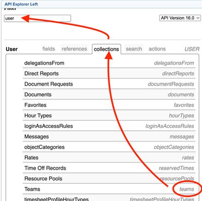

I think if you just use "$$USER.teamIDs" that should include home and other teams.
Madalyn_Destafney
October 6, 2023
Ok thanks. But I'm struggling with what the text mode needs to be in filters to grab updates [I'm] tagged in OR updates a team I'm in is tagged from past 5 days, for example (days may change).
RandyRoberts
October 6, 2023
I'm having the same problem. I'm perusing the API trying to find all the fields involved.
