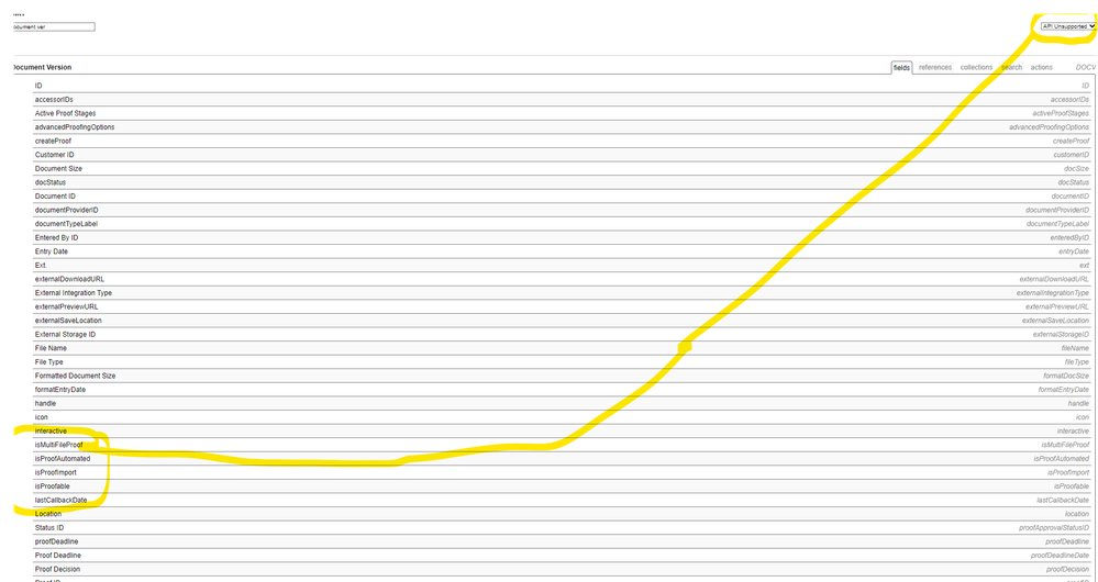

@skyehansen, the isCurrentVersion is only part of api-unsupported, which is why you are able to use it in the exists, but won't see it in other versions (e.g. v15.0)
@RandyRoberts, in addition to the isCurrentVersion trick @skyehansen provided, you might also find the document.currentVersionID of use in an EXISTS join (same concept).
Doug
Doug, either my eyesight is even worse than my optometrist thinks, or I'm trying to gaslight myself. Help me find where the "current version" line is or let me know what is wrong with my screenshot?? Screenshot 2023-09-29 111945.png

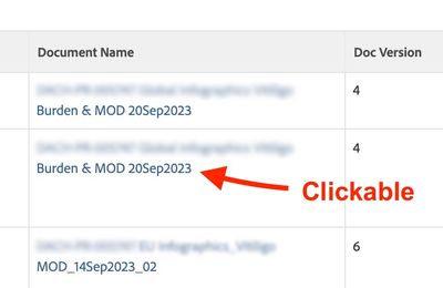

Thanks, @Madalyn_Destafney I was able to get a custom column that mostly works, but I noticed some entries won't have an associated proof ID. Do you know why that is? The note entries can be on the same exact proof, but one will have an ID and the other one won't, which provides a broken link when using {proofID}. I haven't been able to figure out why that happens. The document ID will show for both and be the exact same.
I just used the standard doc name in the wizard
Screenshot 2023-10-02 at 11.49.52 am.jpgScreenshot 2023-10-02 at 11.50.28 am.jpg
Hi Randy, what I think happens there though is you go to the document details page, right? This URL opens the actual Proof directly, instead of details then opening Proof from there. Just saves a click.
That's bizarre, I don't know why it wouldn't show an ID. You have in that filter searching for 'proof comment' to only pull proofs in, right? Not other documents, which have a different URL structure?
