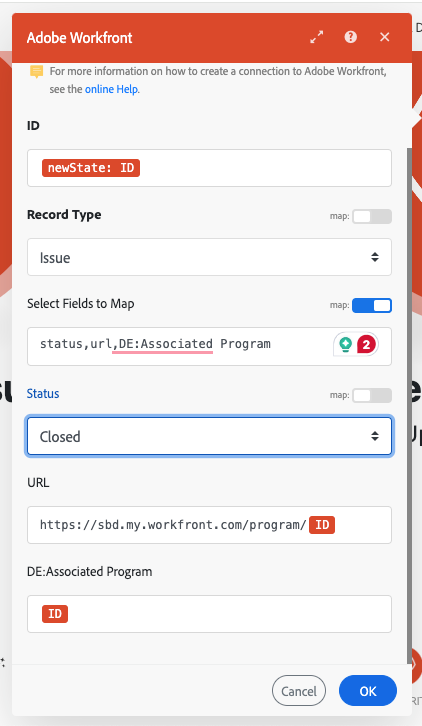

Great question! Natively Typeadhead fields do not provide a clickable link. However, I have fusion so in my use-case I will add a second text field to the form and have fusion provide the URL of the typeahead object for convenience. This may be possible using a calculated field, but I haven't invested time into figuring this out.

Thanks so much. Here's a screenshot of my Update Original Issue module. I have a custom field called Associated Program and it is filled in during the Fusion scenario by inserting the starter URL and the ID of the newly created Program. Hope this helps!!
