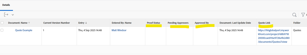

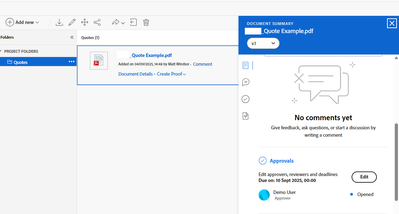

I'm using document approvals but struggling to get a report created that shows the approval status / pending approver. I also need a link that will either open the document (not the document details page) or if not, a link to the folder area. My link open the folder area, but just shows a grey space without folders or options.

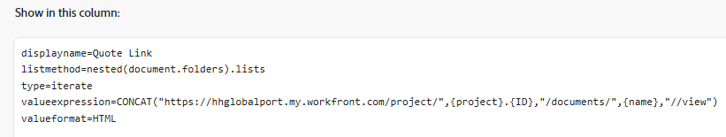

Here's the textmode for the link:
Here's my report I need to populate. Thanks in advance!
I don't believe you can get a link to a folder view. I know you mentioned being able to do this by appending /foldername/view to the end of the URL, but you'll see that if you put anything in the "foldername" part of the URL, you'll get the same result. In other words, the grey space you're getting is because your link doesn't work.
I'm not sure what you mean by opening the document (do you mean opening the proof? or downloading the document?) but it's very likely that the best result you're likely to get by Monday, is the details page as you mentioned getting before.
