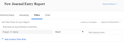

Hi Eric - if you are running a journal entry report you should be able to pull in column for Project name. Is that the kind of report you are using?
KellieGardner
August 22, 2023
You should also be able to filter by project name:

Hi Kellie,
Yes this is a journal entry report. You can see in the screenshot that I attempt to view the project name in the report, but that does not return any results. The filters also seem to produce no results.
I have also tried...
Journal Entry>TopObjID
Document>TopObjID
Document>Project ID
with no sucess.

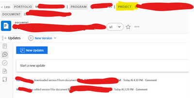

I am able to run the report to filter out Change Types = Download. This seems to pull in every Update that has to do with a file being downloaded which is too much data. We can narrow down by Entry Date, but that still doesn't quite get us the data we need.
This gets me some of the info I need but to make this perfect I need to be able to view/filter by the Project that the file exists in. I have highlighted what exactly I would like to view/filter in the report. Is it possible to pull that data in?

Oh, I see. This is kind of tough, but here's a sample column you could insert that will help underline where the problem is.
displayname=This is where the journal entry is being stored linkedname=documentVersion namekey=view.relatedcolumn namekeyargkey.0=documentVersion namekeyargkey.1=documentID querysort=documentVersion:document:project:name textmode=true valuefield=documentVersion:document:project:name valueformat=HTML
If this column works on your side, you will see that the journal entry is only being stored on the Document Version. This means that in order to reference or filter for anything, you need to start there. So you can see that from the doc version, I was only able to reference the document. From there I had to use the document to reference the project, before being able to finally access the project name. Does this make sense so far?
