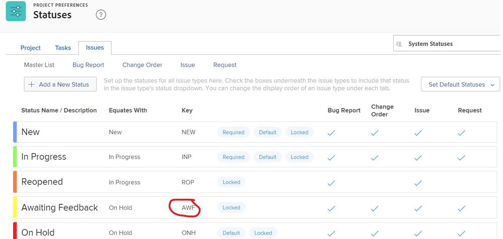

Secondly, for the custom statuses that you have set up, you must ensure that the status key used for the status on each object is identical. In the below screenshot, the "Awaiting Feedback" status for issues has a key of "AWF". If I wanted tasks in an Awaiting Feedback status to sync to issues, I would need to ensure that the Awaiting Feedback status for tasks is also set to AWF
When both of these settings are applied, you should find that the status of the resolving object (task in your case) will sync to the resolvable object (issue).
