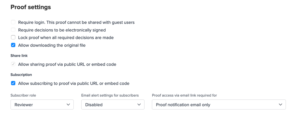

The "share this proof link with others" link has been a huge pain point for us. We haven't had anyone say they need to create a password when that link has been used. So I suspect we have something different in the Proof Settings than you have.
We have "Allow downloading the original file" and "Allow sharing proof via public URL or embed code"
But "Require Login," "Require decisions to be electronically signed," and "Allow subscribing to proof via public URL or embed code" are all unchecked for us.

It is interesting that your third party recipients do not have to use a password. I have attached out settings, but I believe they are the same. Do you leverage SSO for your proof users and do they all have licenses?
As for the authentication email sent to the proof owner, I think that may be in the subscription settings. I am not 100% sure on that one though.

I checked with one of project owners (one who would set the proof routing) and she does not have to approve access for a SME. I'm not sure what would be different in the settings. Subscription must be checked and the original recipient must share the proof with the email link, "share this proof with someone else".
Level 6
that's exactly how I did it but it sent an email to the proof creator to allow access.
The photos attached in backwards order but the bottom one shows our proof settings, middle shows the share this proof with someone link and top shows the email it sends the proof owner
Level 8
Also might want to check the Subscription settings. "Subscriber must click a link in an email to access a proof" - we have this set to 'no emails'. Im not sure if that may be the culprit here.

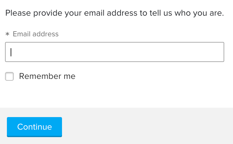

Level 6
changed my setting to "no emails" but the same thing happens. The person who it is shared with gets the Sign In button at the top, when they click that they have to type in their email address. Then the window expands asking for a full name. once they click sign in they get the window saying we received your subscription request and it sends the request to the proof owner0690z000009Cj7fAAC.png0690z000009Cj7aAAC.png0690z000009Cj7VAAS.png0690z000009Cj7QAAS.png
