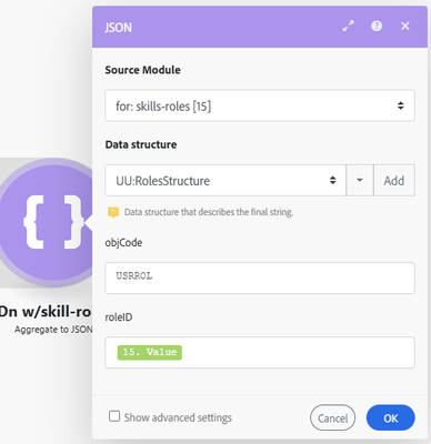

We have this custom API module to update roles:
as you can notice user Roles are updated with JSON string that you need to prepare like that:
and output of this usually looks like this:
hope this is helpful

Thanks Skye, yea, I've been trying via custom API, the userRoles is a nested collection under USER and I've been struggling to find the right JSON structure, if there is one, to allow a POST or PUT to happen to that field.  I'll keep trying and post back if I have any success but to date, not yet.

I think I saw similar question already and I was answering it. Anyway
Thanks Rafal, this is exactly what I needed, I could not figure the JSON structure and what exactly was needed.
