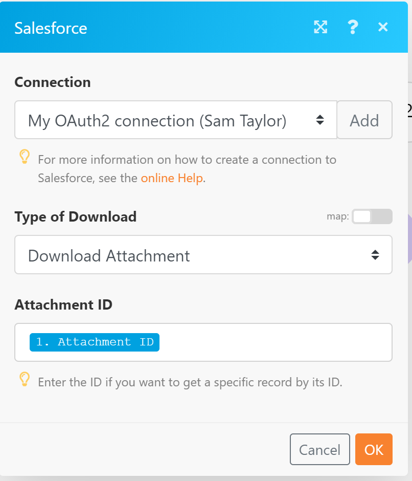

Hi Allison
You can definitely add notes and attachments from SF to a Workfront project. The following scenario illustrates:
The first module watches for attachments. You could do the same with notes.
The second module downloads the data, be sure to select attachment for attachment or document if it's a SF document:
The third module is where I get a projectID. This could be accomplished in many different ways like a search module that returns project ID(s).
The fourth module uploads to WF:
Notice the "Source file" field. Fusion is smart enough to recognize what modules have file outputs and you just need to select the SF download module.
Hope that helps

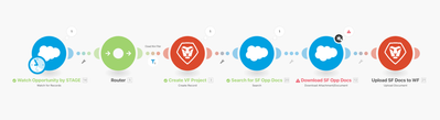

This is very helpful. I'm specifically trying to get Notes from certain Opps to be moved to certain projects, as part of an already existing scenario.
How can I integrate this? My current scenario has a trigger module already, so I can't use the "watch for record"
I'd like to take Notes from the Opp that triggers the scenario and upload it to the created project.
Adobe Champion
Have you used the scenario where you "search for a document vs watching a record after creating a project? I am not getting my scenario to work.
My search module is failing as I have an attachment added to the Opportunity, but I am unsure what needs to connect to upload to the WF project in the beginning of the scenario.
