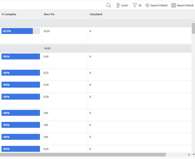

I have the following text mode for the column in the task report:
valueexpression={estimate}*{percentComplete}
textmode=true
valueformat=HTML
displayname=Calculated
on another column I'm using a valuefield, to show the estimate , which is a double. and it is appearing correctly, however when using the valueexpression approach the field shows as "0.0". This only happens for the estimate field, since I've tried with others and they showed the same information, regardless of valuefield or valueexpression approach.
Let me know if the text mode looks correct, or if anyone know what could be causing this issue

yeah, I think you had the right interpretation, here is a screenshot to further clarify.
Essentially, I'm trying to get the value for multiplying the story points (Estimate) by the percent complete of the task. To get a measure of completed story points in the sprint.
As you can see it's just showing zero.

Thanks for tagging me, @KellieGardner@NicholasSily The field for estimate, is a dynamic field in the API which means it cannot be manipulated in valueexpressions. I've asked the Technical Writing team to update our documentation and make that more clear, and if possible, list out any fields that are dynamic to avoid any confusion.

As a means to achieve the result I used the Planned Work field (workRequired), which is the one that is linked with the estimate field. This one can be used in custom expressions, here was the workaround:
displayname=Points Completed
textmode=true
valueexpression=(({workRequired}/60)/8)*{percentComplete}/100
valueformat=HTML
workRequired is given in minutes.
8 hours of work equates to 1 story point (This is the system default)
