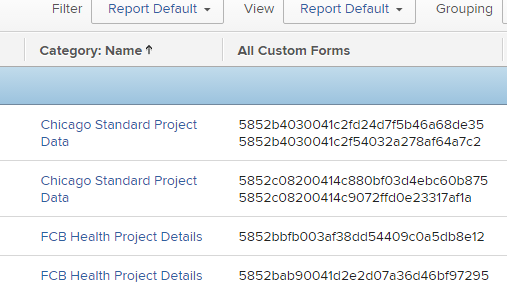

I have a clean-up report to fix those mistakes but when you use the Category field you only see the name of the first category.
I created a report that shows the collection of object category attached to that project. However, the way they are setup in Workfront’s backend, I cannot get the name through the collection. It just isn’t a field option for Object Category. What it does do though, is let me know there are two or more forms attached and I can bulk edit those separately to either remove the extra form and then make sure they have the correct one.
The text code I used was the below. Looking at the API explorer, it should work for you even with a task object type report.
displayname=All Custom Forms
listdelimiter=
listmethod=nested(objectCategories).lists
textmode=true
type=iterate
valuefield=ID

Hi Anthony, Thank you for posting this code, it helped me solve an issue with listing all attached custom forms on a template in a QC view. I am able to get the form name by replacing your valuefield selection of "ID" with "category.name". Thanks again!
