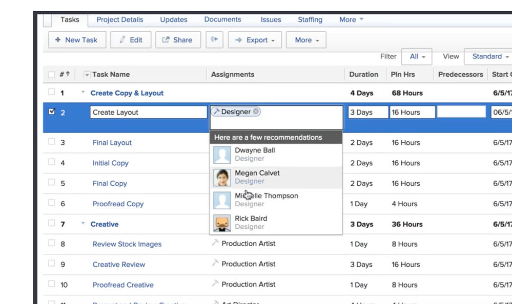

Check out 1:40 in this Workfront training video:

According to an old training video Workfront made, it shows it working as I was originally taught. Only users with the same job role are showing. Now you may say the trainer had assigned those users before, highly unlikely since it's a training video. The other difference is It doesn't even show the logged in user, so we know it has in fact changed. I nicked the video and saved it so I could reference it and luckily I had it in backup. See the screenshot.
