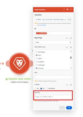

Note (comment) successfully created by Fusion but not visible in Workfront – Why
I’m hitting a wall with this one. I’m trying to use Fusion to add a comment (note) to a task. The Fusion scenario runs successfully, and I can even query the NOTE record type and see the entry there. But for some reason, the comment doesn’t show up in the Workfront UI- when I click into the task and go to the Updates tab, there’s nothing there.
Any idea why that might be? I made sure to set isPrivate to false, but still no luck!

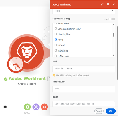

I can post a note to a task with this (you can use 'Note Text' rather than 'html' if rich text isn't needed).
You'll need to pass your task's ID to the ObjID field.

If you're trying to add a comment (and not update an existing comment), I think you need to use a Create a record module.
This works for me (it's for adding a note to a project, but it's the same idea).

Awesome - I got it to work!
I had accidentally used OPTASK as the objCode instead of TASK, which I think was causing the error. Thanks so much for your help!
